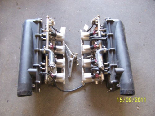

Well there just seems to be a spare set of 355 TB's laying around ! as of about 20minutes ago ??
John just bid and won a full set including injectors, fuel rails, plenums and the lot . Which is for my project and I already have a set of just the TB's here in South Africa. I'll have a look in the morning as to how hard it would be to fit them to the carb manifolds ?
Problem is you still need an ECU ? which is where the money is ? Although how is Mark coming on with his ? Would be a great test bed ?

Dave you are sneaky. Yes, the ECU is a pricey part of this, but certainly not the only part. I was sort of eyeballing the manifolds and wondering the same thing. Matching the ports and getting the 355 manifolds to mount vertically would be the tricky bit. I suppose a small manifold runner could be fabricated from the inlet port to provide the required 45 degree turn so the 355 TB's could fit upright. Not easy, but very cool.

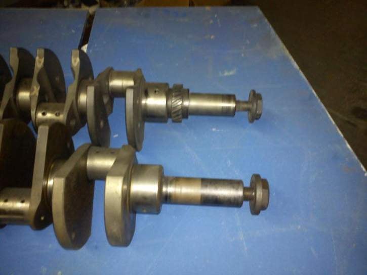

Photo shows 360 crank (above) and 308 crank (below). Pics courtesy of Dave. You can see the bore spacing is the same, but the 360 has larger oil passages and is lighter.
Wow, the 308 is pretty overweight in comparison. How much do 360 cranks run for on the used market? $1k?
It'll certainly be interesting watching this come together.
308 crank = 42lbs 360 crank = 32lbs (I think)
360 cranks are a bit more than that. GT car parts has them for less than $2k now and I found another place who have them for about the same. Getting a tiny bit more common.
Hmmm... interesting. One could increase the displacement of a stock (bore) engine by roughly 8.5% and reduce the rotational mass by 10 lbs... Not a bad deal.

Dave, I am no pro nor am I a fabricator but I bet the only option is making a new fancy manifold between the port and throttle body.
From Mark's thread, it seems like the goal is to get a smooth taper from the TB to the valve... looks like a tough job as is. Maybe a cross flow manifold and mount the TBs horizontally over the valve covers? Another thought is to just make a 2" or so spacer and taper from the TB down to the port. Hood clearance might be an issue though.
The fabrication part doesn't worry me it's the taper as Bret mensioned . If someone can come up with a solution , I'll try and make it ?
What's the rpm target for the engine? The 355 tb runner length is probably optimized for around 8000rpm, so adding 2" for an adapter would bring the rpm they'd be tuned at down some I'd think. It could work if you're looking at making a 7000rpm engine. There is software out there to determine ideal runner length, you'd have to see how close you can get the runner length to tune to your target rpm. If you have an extra set of just the TB's, you could build an adapter for the short term to run stock TB's and then modify the other set to not need the adapter and tune the length properly for your engine. If I were set on using the tb's, that might be my plan...Cool project.

How do they measure this length ? Valve seat to butterfly ?? Valve seat to end of trumpet ?
The TB butterfly is at the top end of the Tb were as on the carbs it's much closer to the manifold face ?
