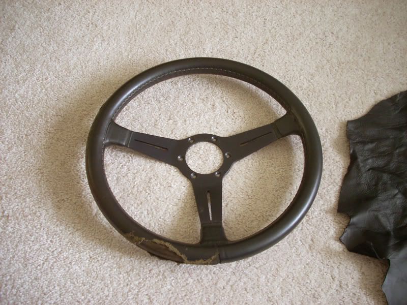

1) Original Nardi wheel is dirty and torn:

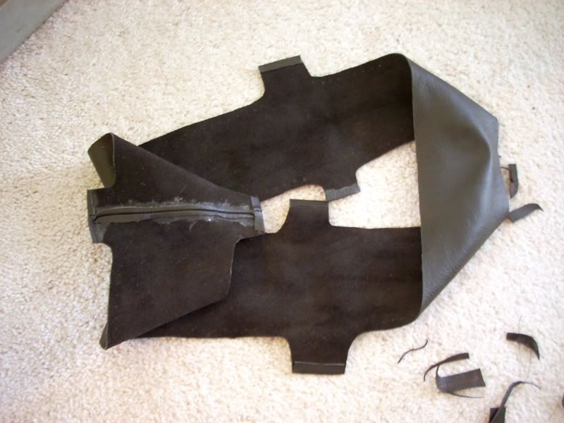

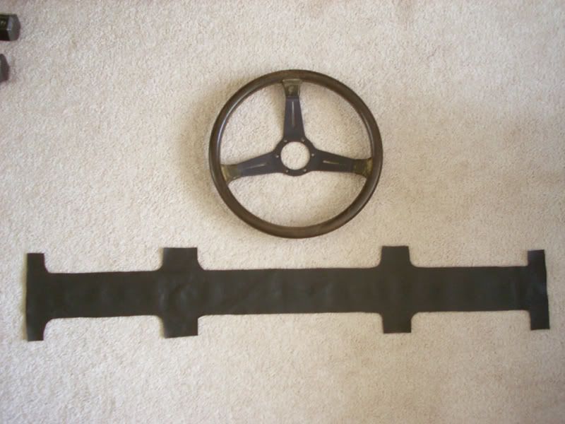

2) Original leather has been removed, and a new cover has been measured and cut. The original does not make for a good pattern because it is curled and shrunken, and the new leather will stretch. There is a little bit of estimation required in measuring a new piece.
The original wheel was only stitched along the rim, and separate, small pieces of leather were just wrapped and glued around the spokes. I prefer the more complete look of a single piece of leather with stitching going up the sides of the spokes. This is more difficult to do than just straight around the rim. Initially, I purposely cut the spokes too wide, to be trimmed down more exactly during test-fitting:

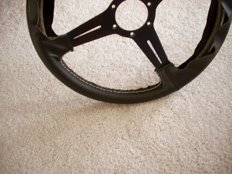

4) The cover is test-fitted again, the spokes are trimmed slightly more for better fit, and then I begin stitching the new cover in place.
When sewing by hand, it is easier to use waxed thread in a steering wheel cover, which helps to prevent the loosening of the last few stiches as you move forward. But the original white thread from the Nardi wheel was not waxed, so I followed suit. Also, wheareas many steering wheels cross-stitch over the top, the Nardi has parallel stitches on top that cross underneath:

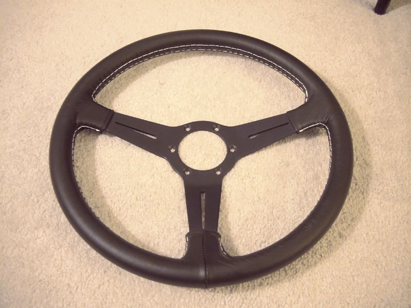

5) The wheel is stitched up. The last step is to brush contact cement on the undersides of the edges and inside of the wheel, and press the edges of the cover into place. Here is the finished product:
It's not perfect, but I am quite happy with it, and it looks impressive mounted on the car.
