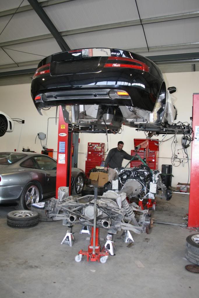

Agreed. There are a few things to watch for on the early DB9's, there was a software update for the engine ECU's, and listen out for a rattle on idle, there is a transfer plate on the flywheel which breaks up and it means dropping the whole drivetrain to fix it. A few early cars had a problem with incorrect dipstick lengths which caused engines to be run low on oil. Here's one i had to fit an engine to because of the resulting damage!

Just another day in the office, eh Eddie?! LOL.
